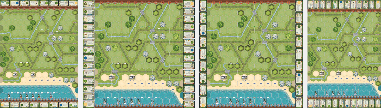

Wow, it works like a charm. Thank you very much for your effort! I have a short question, maybe someone else had this problem: I would like to recreate the D-Day landings, but I cannot find a method to create the additional ocean tiles. Is there a simple solution for this issue?

Unfortunately there is no simple solution to the ocean hex problem, as the editor (either version) does not allow their placement.
When creating maps of the BT versions I created the units on the ocean hexes as a separate layer (using ‘Exclusions’) then added the sea hexes in GIMP. I then merged the 2 images together to produce the final version. It should be noted, though, that some of the more unusual coastal hexes also do not exist in the editor, but can be copy and pasted from the BT versions.

Just finished the first map. Regarding the ocean tiles, I used a spare tile in the editor that wasn’t used elsewhere and replaced its image with the existing ocean tile. The only missing part I copied from the source you mentioned and applied the same method to another spare tile. Again, thank you very much for the tool and your support.
